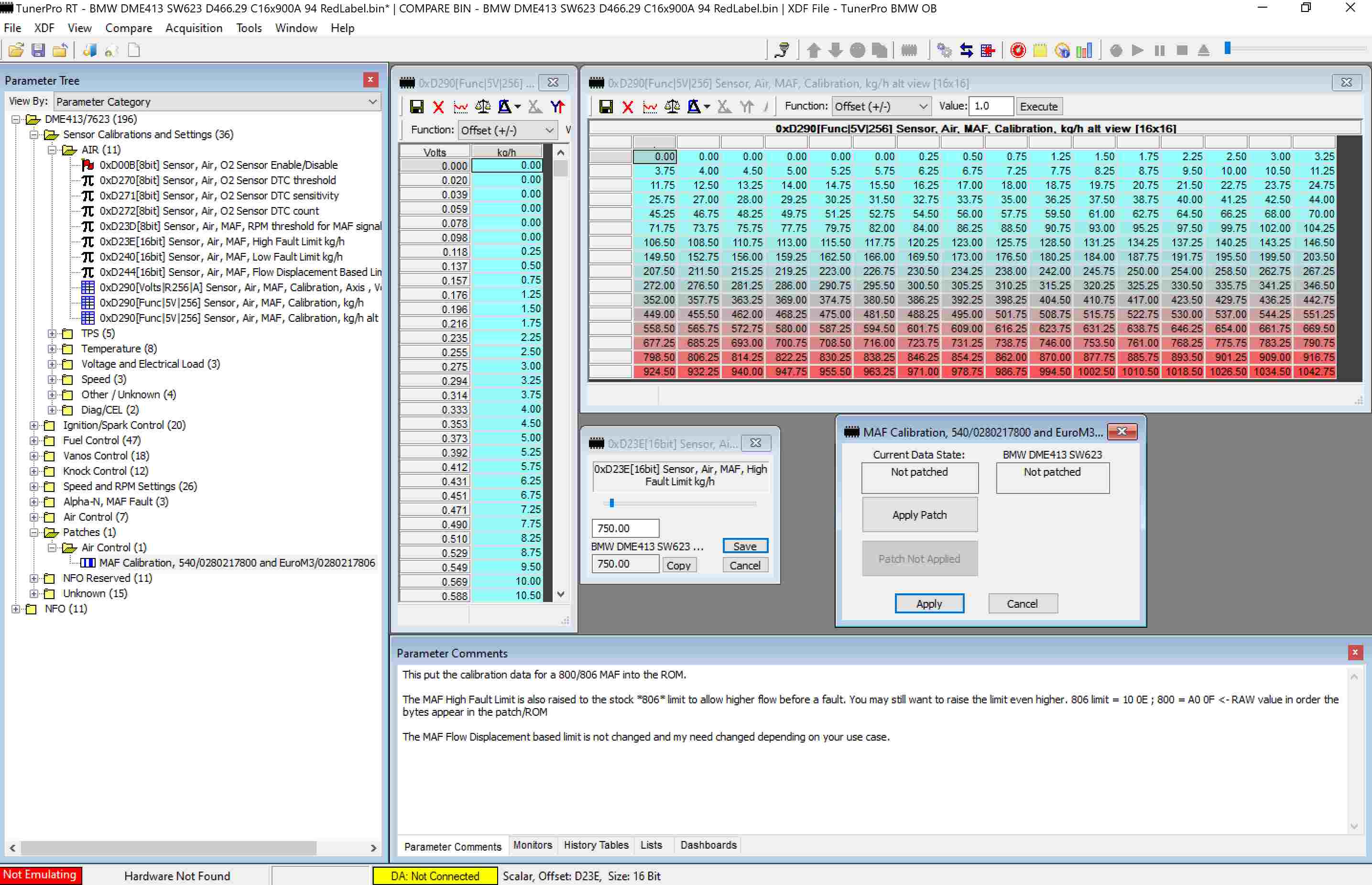

With 2025 being roughly 30yrs since the end of OBD1 I think it's about time to get all the community information together.
Maybe giving the old code a kick will catch the eye of old tuners that may now be willing to share more secrets, or correct some errors still propagating in the XDFs.
This will not be a tuning guide. This is documentation and trying to understand the Motronic 3.3.1 code and data.
Work in Progress

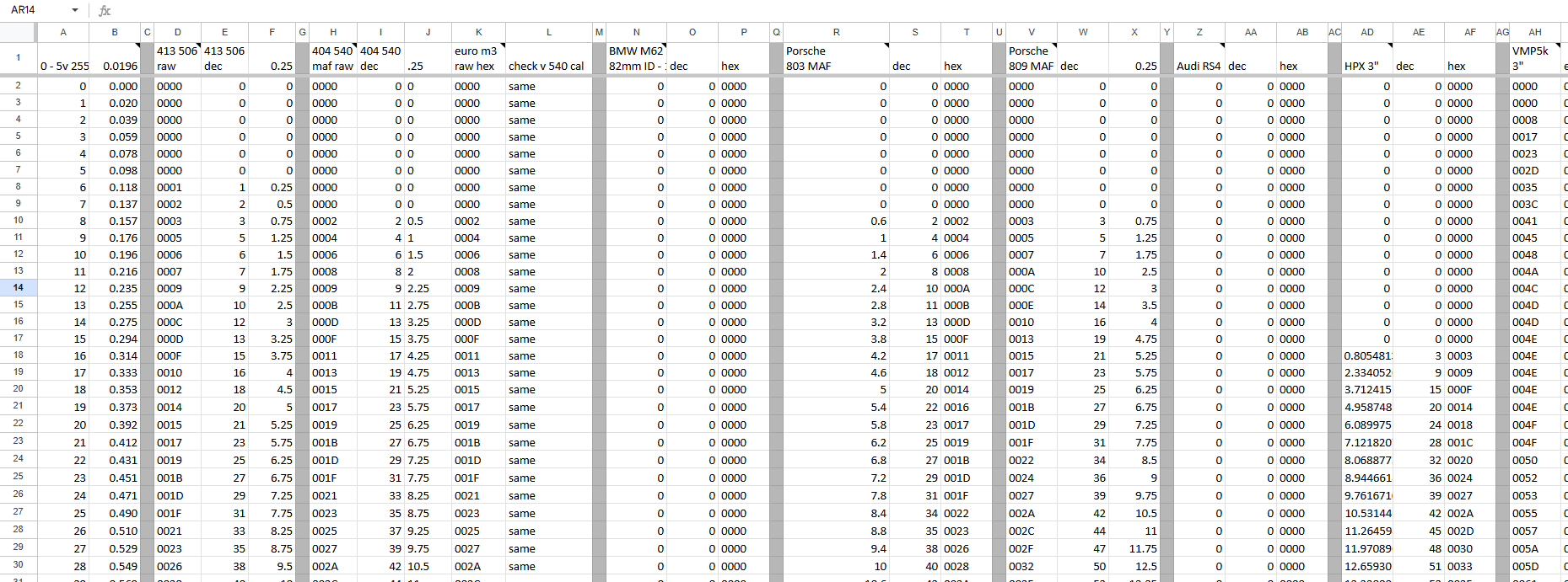

1. Cleaning up and continuing development of the 413/623 Google sheet that is based off of Hairyscreech excel file. This sheet is linked below and anybody can add comments to help out. Currently only I can edit the sheet. I am using cell "notes" to label data. I am using cell comments for discussion and to make links to jump to locations.
Out of scope until after 2025 is getting into the code disassembly. I'm an ME not a CS so that is going to be rough for me.

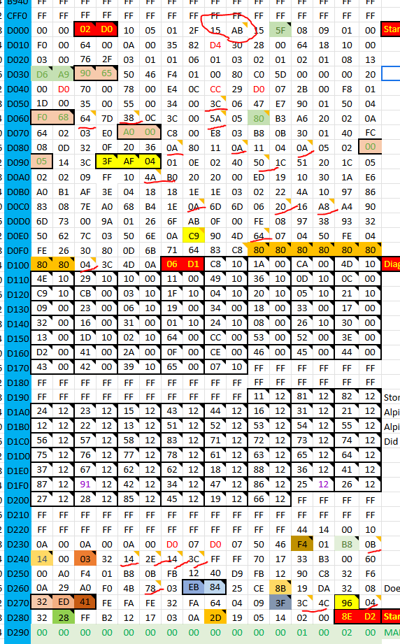

Putting the project files here:
XDFs:
https://github.com/NomecOne/BMW-DME-M3.3.1
Google Sheet to define ROMs and other info (this has some copy paste from Hairyscreech and others):
https://docs.google.com/spreadsheets/d/ ... sp=sharing
you can view and add comments to cells to help define the 413 ROM and other items
Fun fact #1 there was a portable BMW tool called a MoDic that could plug into the diagnostic port of a M3.3.1 car and program an update to the eprom if it was small enough to fit into some yet unknown reserved space on the eprom. Additionally if a blank chip was put into the DME the MoDic could, through the diagnostic port, program the whole eprom. -source BMW TIS documents.... I guess everything to program a chip is onboard then. That would be quite the trick if somebody figured out now how to program/burn eproms using the DME itself like the MoDic could.
Work in Progress
XDFs:

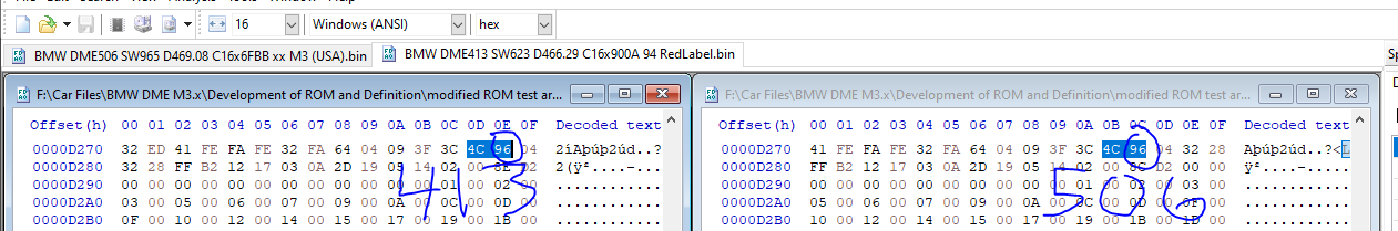

Fun fact #2 the checksum location can be moved. There is a table of locations that defines the checksum region.

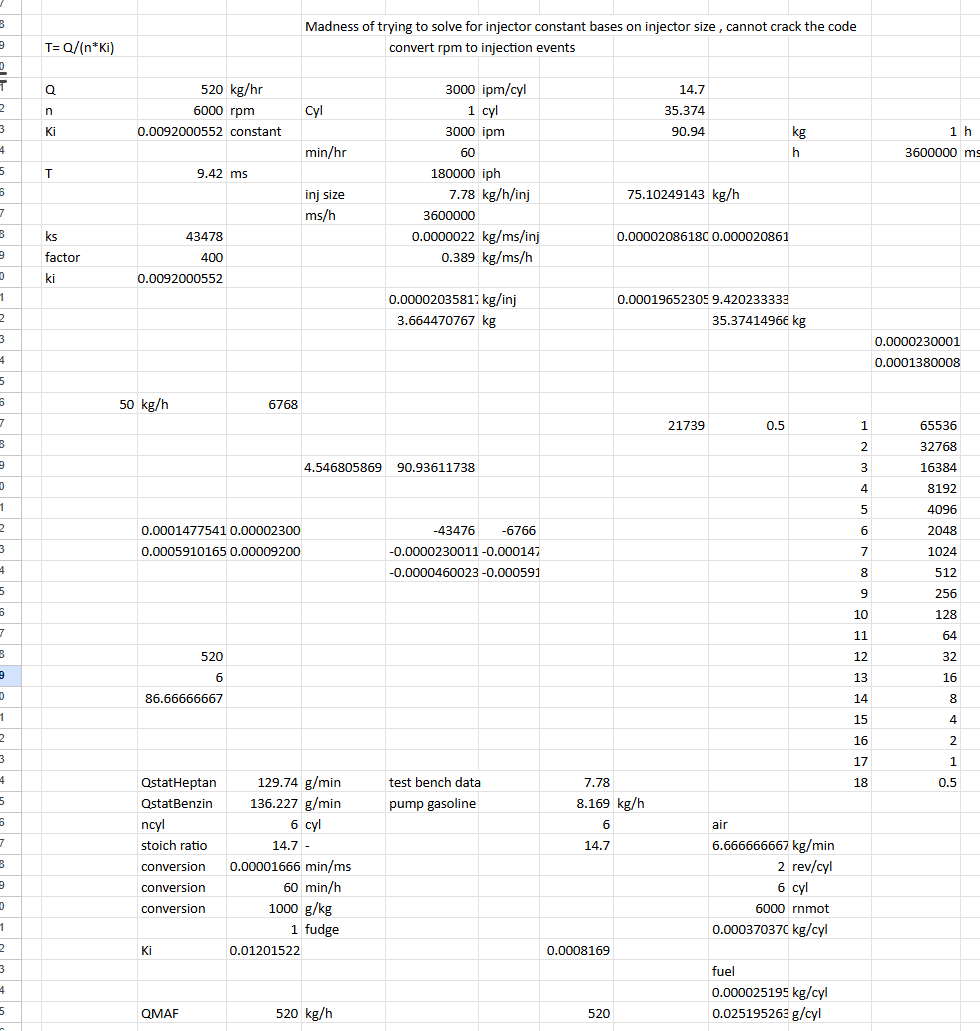

Fun theory #2 injector size affect on injector constant if you are changing it
Not a complete list but a summary of roughly what the values are.
4 Ways of looking at the same information:
pn..........;descrip......;#/hr..;Inj.C.;Hex..;Factor
280150415;95 m3.......;17.16;43478;A9D6;1.000
280150440;Pink 96m3..;21.50;34702;878D;0.798
280150927;-.............;23.50;31748;7C04;0.730
280156370;alpb3s pink.;23.80;31348;7A74;0.721
280150947;Blue.........;25.50;29258;724A;0.673
280155715;Light Blue..;25.60;29144;71D7;0.670
280150218;-.............;31.32;23821;5D0D;0.548
280150934;-.............;31.32;23821;5D0D;0.548
280150945;red..........;32.10;23242;5ACA;0.535
280150431;-.............;35.64;20934;51C5;0.481
-............;Dark Blue...;39.77;18760;4947;0.431
280158227;-.............;41.43;18008;4658;0.414
280150558;green top..;45.20;16506;407A;0.380
280158123;12ohmev14;62.86;11869;2E5C;0.273
280158040;-.............;90.48;8246;2035;0.190

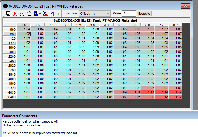

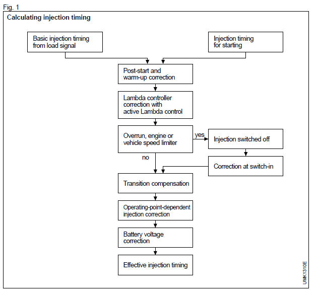

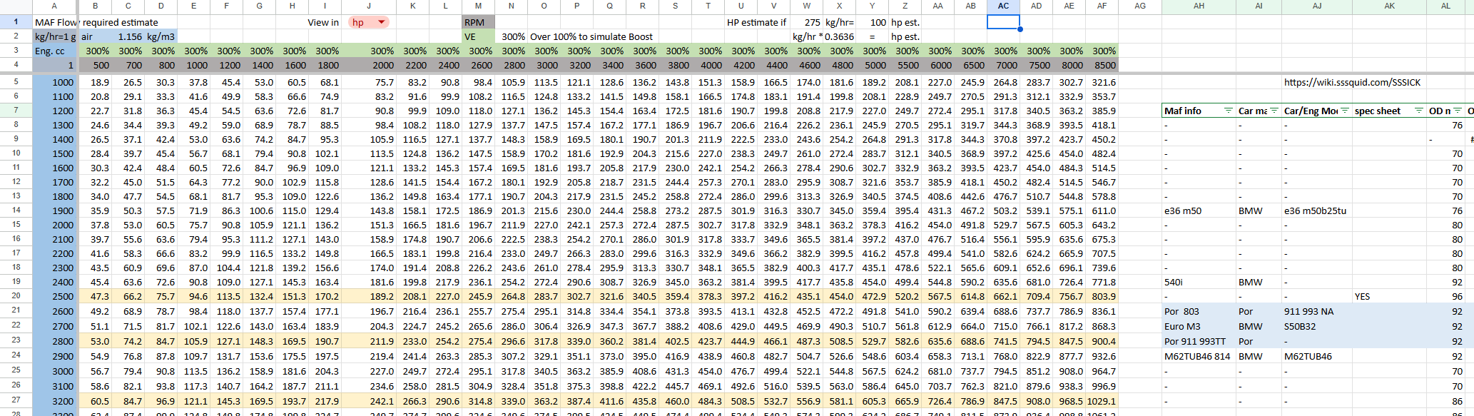

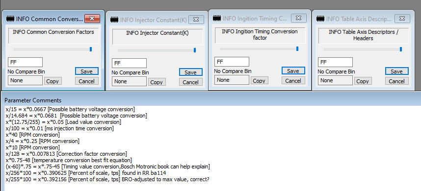

How should fueling correction table data be viewed? What is the most correct?
Main fuel tables are RPM v. Tl(Time Injection Basic)(ms). The data in the table is correction factor at that point. Over the years of following this topic most people,I think, and most public XDFs for sure do one of the following with the table data:
1. leave it as a raw decimal value with 128 being zero correction ; conversion = x
2. converted to lamba / This is also becomes what could be viewed as a multiplication factor after converted ; conversion = x/128
3. Converted to afr ; conversion = (1-(x/128-1))*14.7 (or similar, I can't recall the eq used)
#1 is reasonable to just leave it and not worry about it. More is more fuel, less is less fuel
#2 lamba NO but, multiplication factor yes. Depends on how the program uses the data in the table.
#3 Just NOOO its not AFR
Have seen Olafu post that 64 = 0.5x fueling and 255 = 2x fueling which leads to believe it is multiplication factor.
Also the old Jim C quotes posted all over are OG source.
So I think the best/most accurate way that all the correction maps should be viewed is with data conversion factor as (x/128). Does this seem to be the best way to format all the map data as we continue to drive to a point to complete the equation Ti = (Tl * [C,D,E...]) + Tv
Tl = Q / (n * Ki)
With Tl quantified, we now take into account the vagarities
of the particular engine family and operating conditions by
introducing multiplicative factors to correct the theoretical
injector time to the ACTUAL time for injection (Ti) needed
at that instant. Finally an ADDITIVE factor (Tv) is added to
compensate for the differing injector opening time under lower
than nominal voltages.
JimC

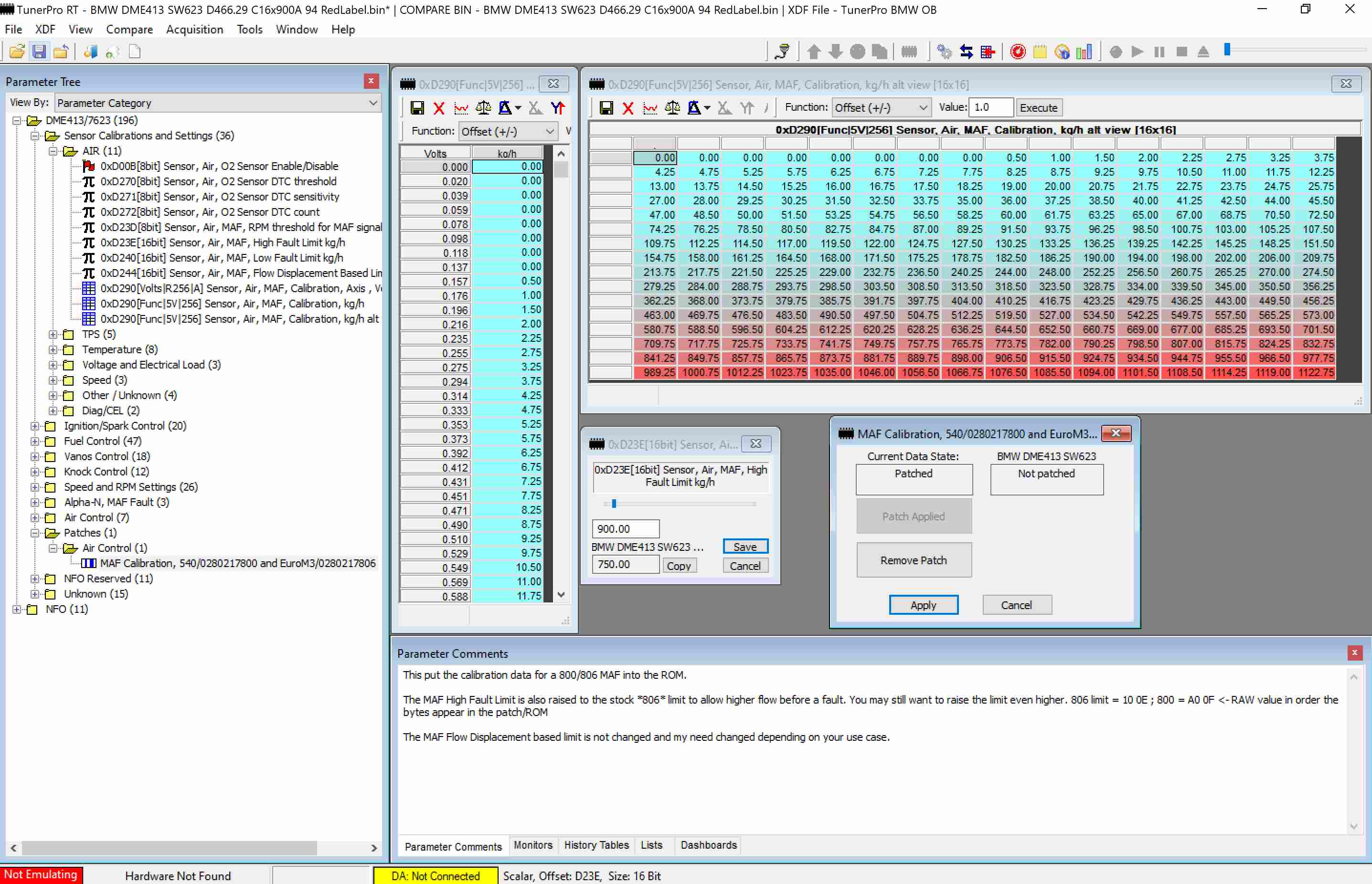

Micro progress on side questions. The ba114 romraider 413/506 definition file has a few things in it that have not been discussed I think. I will warn the 506 rom there is a wacky one that is the same as what miller performance cars based there warchip rom on.
On the topic of a collaborative spreadsheet being available on Google sheets, I am getting closer. The programming dream team of chatgpt and me have made scripts to help convert all the notes/comments/data validation messages that hairyscreech did into notes on a Google sheet. Without the scripts it was either lose the info or copy paste one by one.
I have collect a few more ROMs some stock, some NA performance, and some FI big injector.
On the 413 XDF I have been going back over it and updating wording and descriptions with the latest info. Changing the conversion factors on some items to align with know and some assumed equations the data goes into. I am having second thoughts on doing the XDF creation all in the GUI. It's a bit clunky in some regards trying to implement "advanced" features for me. Maybe it's a skill issue on my part.

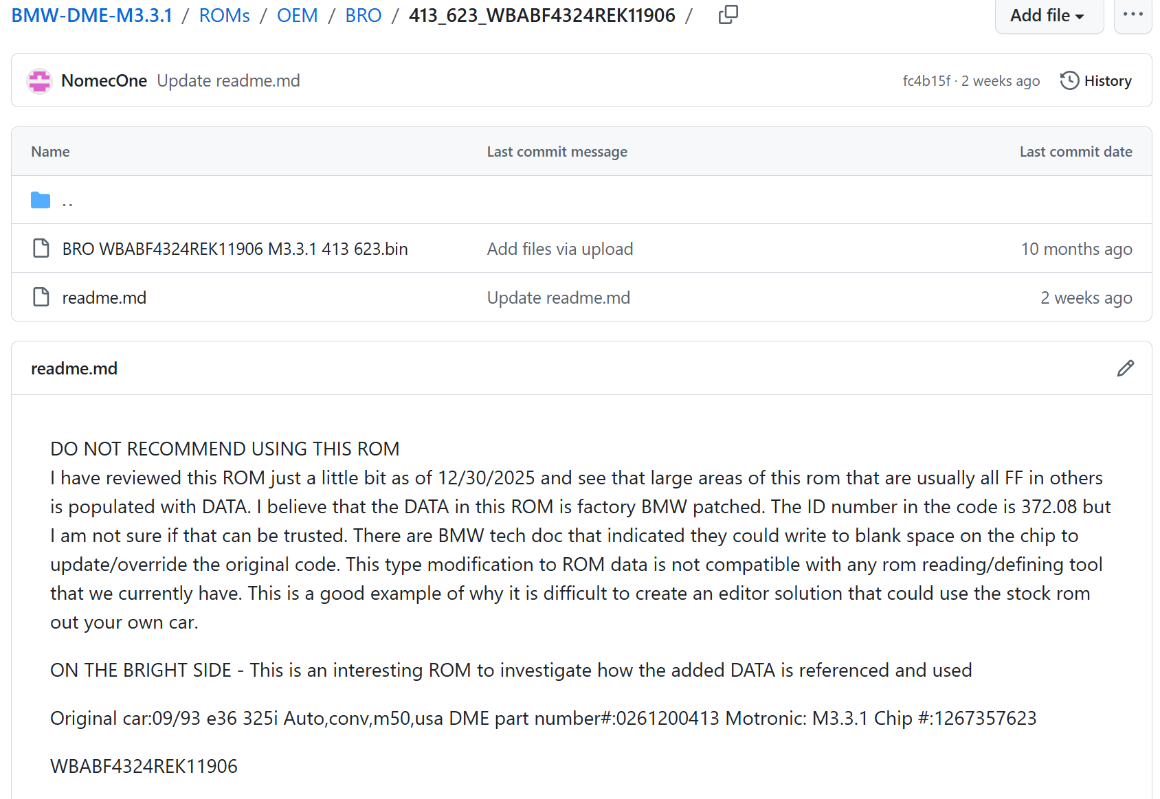

I have added some ROM reads that I personally have taken to the github. I have more to put there but I have to label and organize them.
I have an oddball 744 software version of the 413 ROM. I have not crossed the 177 or 609 software versions in the wild yet. Also some screenys of the google sheet to define the 413/623 ROM. A lot left to clean up and a lot of undefined values left to uncover and document. I'll keep chugging alone solo for now. Seems I am the unlucky one as nobody else has the time and interest right now. I missed out on the 2016-2019 progress. Wish I would have been active then.

The ba114 account on GitHub that made a romraider profile(a pretty good one too). The 506 file he posted in his GitHub is not original in my opinion. It's an exact match for the file that miller performance cars used for their war chip. They moved the cranking fuel map and checksum and some other stuff is messed with. Millers encrypted files and the ba114 posting are the only places on the net I know of that specific file existing. So there is some connection there. I thank them for their work. I submit an 'issue' to them on GitHub to warn about the 506 file.
I have not found anything interesting in the 744 software other than it exists(I have not really look at it though). I never have seen anybody mention it then, I got a dme to read and it was 744.
I have ROM overload this plus all the online files found. Got a stock 506/623 chip last week for $5.50 USD...I probably have a problem.

Worked a bit on MAF selection sheet and the database of MAF calibration data sheet. More to come. Thanks to ba114 and the MS41 community for a lot of info. Some data if from other sources, some I have personally verified in multiple ROMs, and some from MAF companies.
I have focused in on there most common MAFs and the "best" MAFs.
I have reread a lot of old thread on 540/Euro, 803, and 809 MAFs. With the knowledge I now have from going through a lot of ROMs it's cleared up a lot of confusion.
First 540/Euro MAF the volt vs airflow data stored in the ROM from a 540 and a Euro M3 are exactly the same data. I have read the ROMs myself and checked the data. It's provided in the Google sheet linked in first post. Second this MAF is only viable if you get it cheap and you are doing NA only. This MAF only adds 50-80kg/hr of head room total. The errors start well before the kg/h listed at 5V. The max threshold error limit in the ROM has to be adjusted to do a MAF calibration for a higher flowing MAF. With that known, you can change the threshold while retaining the stock MAF and get almost the same max airflow as the 540/Euro MAF. Unless the bigger diameter actually comes into play affecting the power output there is not much reason to go to a 540/Euro. The 540/Euro also does not have enough flow capacity for boost application. For the cost cutter budget people you could do resister mods to pull down the voltage and make a customized calibration, and accept the cons of losing the low end tunability. There is a sheet with a tool to help with the(lifted from ba114).
You can also see the 803 MAF does not have a lot of headroom for boost. The car it was on was only in the mid 200s... I only have ba114 calibration data on the 803 MAF. I have a few ROM dumps that should have the data but I cannot find it...unless the ROMs I have are not right. This MAF has just a little move head room than 540/Euro MAF. 803 would need resister mod to run much boost.
809 MAF finally enough room to run boost but if you want big HP it's still not a got enough airflow range. The data in the sheet is pulled straight from a Porsche 993TT ROM that I did myself to confirm data posted by others. I'll post the ROM and the XDF(that only has the MAF data defined).
So that leaves you with what I think is the best options if you want to change MAFs. HPX or VMP MAFs that come with calibration data that can be adjusted for the intake tube size you want to run/what HP capacity desired. There maybe some other MAF brands that are viable, please mention them and I can add to the spreadsheet(and later to calibration setup information).

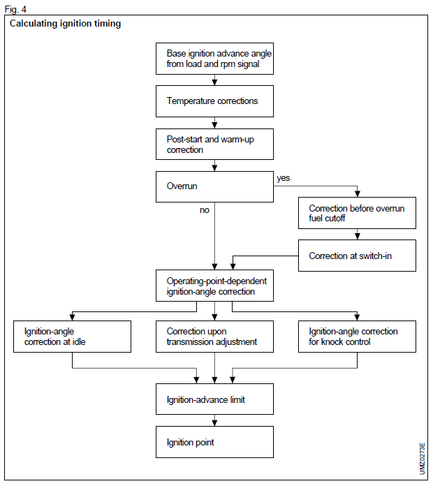

The Bosch book about the M-Motronic system that all that enter should read
https://e28goodies.com/wp-content/uploa ... uction.pdf
Two flow charts that set the foundation. The BMW software is customized off of the base system so remember your grains of salt.
Fun here is that the way Bosch words it the LOAD signal in the output of the MAF. MAF signal is Load in the Motronic system as stated by Bosch. The history of 413 tuning like many other communities has call the "basic injection time" the LOAD. It can be seen as a processed and converted load indicator(given your injector size and fuel settings). This one reason that I believe so many are confused from the start.
So maybe a better description of the main fueling table axis(and all that are indicating a load level) would be:
RPM vs. "Basic Injection Time Calculated from MAF Load signal with Injector Size Constant and Fuel target AFR Accounted For'
That is a mouth full though.... SOOOOO...."LOAD"

I can't help but look at MAF data. I am a LARGE MAF ENTHUSIAST.
This is a table based on the MAF data I have for the HP estimate that you would hit the error limit of the MAF...when you set the max flow to the 4.75V flow. You could push higher into the voltage range but you have to leave some up there I think for noise overhead and the like. The stock settings limit for the M50tu I believe is 750kg/hr or ~ 4.25v limit. So the biggest gain for the stock/540/euro MAFs comes from editing the limits in the DME not actual hardware(ignoring potential efficiency increases from the larger diameter MAF)
This assumes no resistor mod. It is known that when the 803/809 MAFs were popular that resistor mods were used to change the measured flow range.
The 803/809 MAFs are $$$$ now and not worth it for turbo application, Plus the hassle of developing a your own resistor mod + custom MAF calibration to suite. The 540/Euro and m62 are good candidates for high output, high rpm NA builds.
The HPX and VMP5K are now the obvious choices for turbo builds given the cost and data given. Each can adapt to your HP goals with a housing size + calibration change. Calibration data tool are provided by the manufactures. You can further down-select to the VMP5k 3"(tube) if you want to run 3" charge pipe and be north of ~575HP, from these estimates anyway. The HPX would need a little larger tube to measure up there or, take a look at the HPX-E version. HPX-E will be a lot closer to the VMP5K with a 3" tube, Calculating for what size charge pipe would be the most efficient in your operating range is probably a good idea before you spend spend spend.

Have been adding several items in my WIP version of the 413/623 xdf. I have a lot of touch up work to do yet but I am running out of new sources of information without a ton of real car test time, a SIM bench + the time, or diving into the program disassembly time sinks.
I started to wonder how much of the calibration data the community has defined over the years. Excluding the program portion, just the calibration data.
~67% has been defined. I did given some 0.5 scores on areas that are only sort of known. Sure there are some mistakes in there. I am working through table by table cleaning up and doing sanity check on them.
Adding more info to the XDF where I can. I am bending the proper use of the XDF a little trying to make it a one stop shop for information.

I have been trying to resolve the injector constant into its parts. It much be made up of a value representing the injector size, unit conversion factors, number of cylinders, stoichiometric ratio(possible the value stored in the ROM is used), and revolutions per cycle. Google gives results with many attempts that do not work out...so far. I'll come back to this later. Driving into MADNESS:

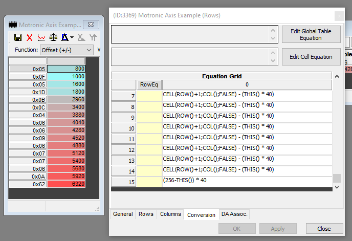

Per my other thread about TP handling of cell equations I have found that 256 is used in a bunch of equations and it most likely should have been 255.... great.
*update* still hard to say what is right. Rpms look "cleaner" when its '256-' and I do not get any issue with conversions. '255-' makes some axis start at zero which make conversion calcs based on RPM ugly. mult or divide by zero. So what is 40RPM difference among friends?
I do not really want to be a perfectionist. I know I am still making mistakes. My plans however are to finish 413/623 then apply that info to all the BMW motronic 3.x versions. I do not want to keep propagating errors. I have been having good luck with writing scripts to parse the ROMs. End goal is something that can output an XDF based on the ROM or a file based on the ROM that Tuner Pro can import. I would also like my scripts to be useful if you want to use ROMRAIDER or other apps I have yet to explore, generally make as much of the BMW M3.x info available to everyone as I can. Right now I am 413/623 and TunerPro focused.nomecone wrote: ↑Thu May 01, 2025 5:37 am I crossed this...
https://www.tunerpro.net/examples
Note here the use of 255 Then in the example files linked on the page 256 is used 255 seems to be correct to me. Max value is FF = 255
(256-255)*40 = 40 this does not seem right. Should be zero.
(255-255)*40 = 0 this seems right to me
Looks like most if not all motronic xdfs copy pasted from the example file and now have 256 in every occurrence of the equation. Not my favorite type of fix to make. WHOOPY. Maybe time to cross the line and hand edit the XDF in Notepad++

Re: M3.3.1 413/506 DME XDFs 'M3.3.1 Missing Book of Misinformation'
I played with making a patch in TP to see what it was like. Bit of a hassle but can be made. I used the MAF calibration as my test subject. First thing I found out was the patch appears to be limited to 256 bytes. MAF cal is 512 so it take multiple entries.
I am using the 540(800)/EuroM3(806) MAF cal data for the patch. I made the cal change then I moved to checking the new MAF high fault limit in the 800/806 ROMs. Turns out that although the cal data is an exact match the MAF high limit is set to a different value. This makes sense. I went with the 806 high limit setting for this test patch. I patched, I un-patched, and used to compare ROM/BIN to make sure it was doing what I wanted the patch to.
I think this was the sort of thing that was the wet dream of the BF tuning threads 15-20yrs ago... "Somebody could make an xdf and just make patches so we could easily swap common parts instead of buying a $$$ chip tune every time a part is changed" ... Well, that never happened publicly until now - 15-20yrs too late to be cool.
Before the patch
Patch applied Patch Setup Some other generic patches should work fine. (Idle RPM for light flywheel, RPM limits, Speed limits, etc)
I would like to collect the data needed for coil swaps to have patch data for those.
I would like to better understand the TPS so other TPS/throttle bodies could be calibrated and patched in.
The injector constant change....the TunerPro patching mechanism is unlikely to be suitable for this...but I will look into it anyway.
Before the patch
File believed to be the Alpina B3 3L ROM dump is now on the project GitHub.
- Screenshot_20250510-013923.png (107.37 KiB) Viewed 192038 times

- Screenshot_2026-01-05_005747_optimized_250.png (115.7 KiB) Viewed 158235 times

You've done a great job, what are your ideas now? I spent many hours in Hex and Tuner Pro.

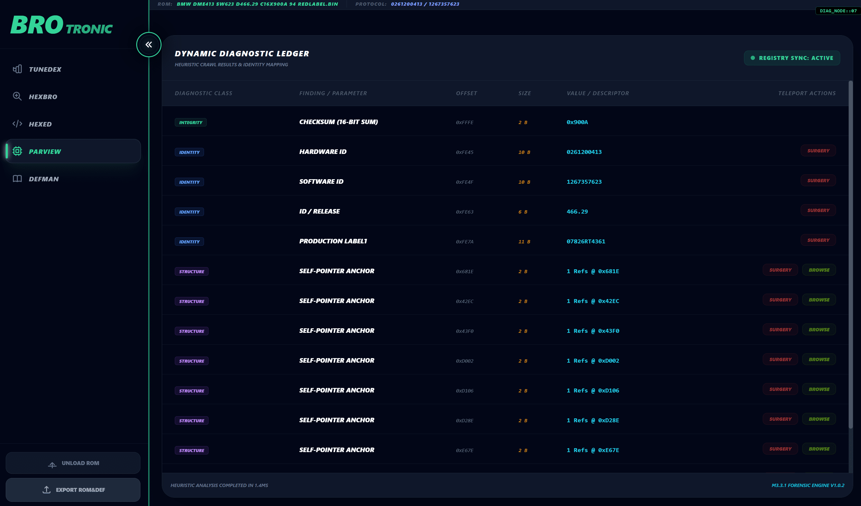

Have to get the parse to parse the whole data section. It only finds a few items at the end of the file so far. One of those things it finds is the offset location of the table of table aka index of tables. So next is to parse the index of tables and then use that info in the parser to parse every table of data. That will get the biggest chunk defined. then I will get into parsing the constants/settings sections.
Right now, because I have so little experience programming beyond simple single file scripts, I am doing small proof of concepts in different backend layouts. I want to be able to parse BMW Motronic 1.x - 3.x variants in the end. I need to figure out some way to make it modular enough. I'll need to learn a lot about programming to get where I want to go..... Other AI option is I could work on turning the spreadsheet into a huge notes definition text file that AI can read. From what I have seen learning more programming would be better. Seems things so niche like this are hard for the AI to do right. Other more common stuff AI can spit out a decent working app that works.

Tuning pink for NA with injector constant for a car that did not come with that size injector would be possible but likely overkill and that hard way for a change that put you outside the load takes range. For small changes when you re not maxing out past the load tables highest load value you can stick to tuning some of the much more simple injector correction factors. See Alpina tuning for larger injectors for NA. then put bigger injector in and then one of the table that is always at no correction standard and offset the value down to compensate for the small injector change. Only works because the make power aka LOAD value still never exceeded the scope of the tables in the ROM. As soon as your power level makes the load exceed the tables scope the injector constant needs to be change to scale that load value back into the table. (I am sorry this is so confusing I am still trying to understand it better so I can find a better way to explain)
No VE tables exist in the motronic version I work with to my knowledge. VE is in the backend of the code/equations and the tuning tables are all compensations for fueling to cover variations in VE and other factors.
My focus has shifted to learn enough coding to create a rom file parser. Hope that after I do a 413 variant I van make tweaks from there to handle all the 413 versions and 506 versions instead of hand defining every byte and sometimes bit for every version that I want documented... which is all of BMW motronic M1 up to M3.3.1. I cannot do all of them by hand though...I won't.
