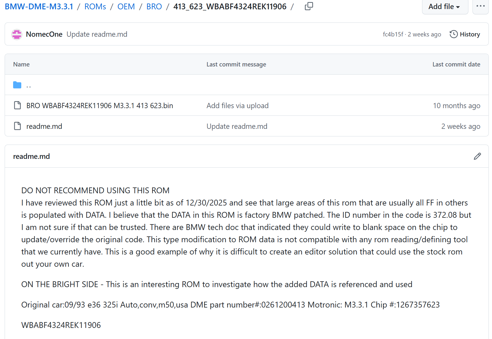

File believed to be the Alpina B3 3L ROM dump is now on the project GitHub.
- Screenshot_20250510-013923.png (107.37 KiB) Viewed 49033 times

- Screenshot_2026-01-05_005747_optimized_250.png (115.7 KiB) Viewed 15230 times

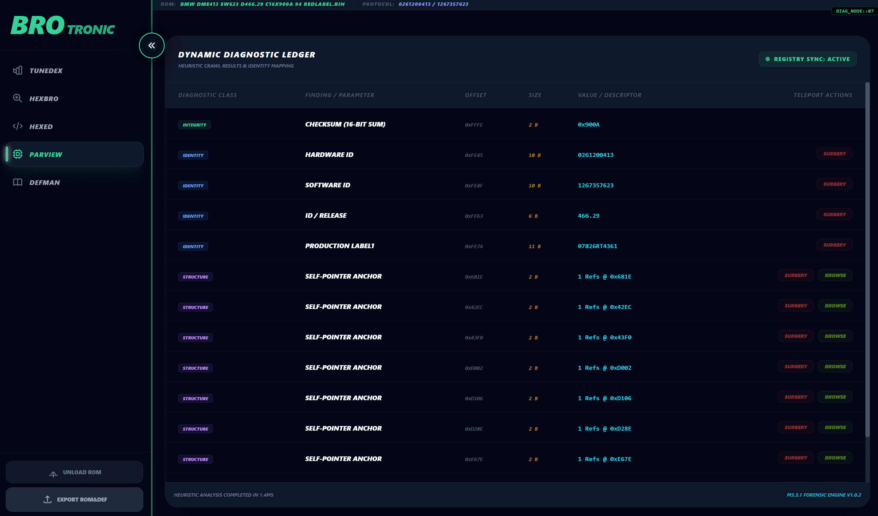

Have to get the parse to parse the whole data section. It only finds a few items at the end of the file so far. One of those things it finds is the offset location of the table of table aka index of tables. So next is to parse the index of tables and then use that info in the parser to parse every table of data. That will get the biggest chunk defined. then I will get into parsing the constants/settings sections.
Right now, because I have so little experience programming beyond simple single file scripts, I am doing small proof of concepts in different backend layouts. I want to be able to parse BMW Motronic 1.x - 3.x variants in the end. I need to figure out some way to make it modular enough. I'll need to learn a lot about programming to get where I want to go..... Other AI option is I could work on turning the spreadsheet into a huge notes definition text file that AI can read. From what I have seen learning more programming would be better. Seems things so niche like this are hard for the AI to do right. Other more common stuff AI can spit out a decent working app that works.

I updated the note on a stock OEM file thatis on the github
