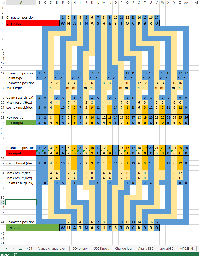

Re: olafu VIN2HEX
I'd like an award for most useless contribution for actual tuning, I think I have it. I need to confirm with more VIN/HEX code pairs but I think I have the cipher figured out.olafu wrote: ↑Wed Jan 03, 2018 7:35 am VIN code, date of manufacturing and some other information is located at 0xFEBE. INPA can show it clear, but it's not in ASCII format in BIN... And it's not directly written, it's splitted in "blocks" or something. Can somebody explain how that code can be translated to VIN? :D
VIN's first letter is located at 0xFEBE: (in dec:) 0=0, 9=9, 10=A and 32=W, 33=X and so on. But that works only with first letter. Third letter comes next, then 4th and 5th, but i didn't do more research.
There are a bunch of apps that do this but none say HOW. I can only do the VIN. I do not know the other data now. I do not have INPA or other soft setup to read a car. Only BINs.
The count as you described is used on odd characters(char1,char3,etc) in the VIN. The evens are masked with carefully picked substitutes that have a pattern. The VIN is 17 characters put into 13 bytes. Which means compression of the data or overlap. On the up side 13 bytes has has 26 characters to play with.
The first VIN character is the freebie as you said, THANK YOU(for everything in every thread not just this). There is no overlap of data to handle, its always the results of a HEX count to 23H/35decimal. All as you said.
Gets tricky from here on. 2nd VIN character is substituted with 1 byte from the associated mask. 3rd VIN character uses the Hex count. The 2nd and 3rd characters Hex that is 2 bytes is overlapped by 1 bit. The overlap is added? Shifted?(I'm not a CS so I will be lucky if I used bit and byte correct in this post).
The overlap and addition(?) continues to the end 2-3 overlap, 4-5, 6-7, etc. VIN 1st char no compression 1 char = 1 byte. Rest 16 chars = 12 bytes = 16bytes-4bytes saved by overlapping data. 1+12 gets the VIN in 13bytes

- Spreadsheet to do the work. When proven will go public.
- BMW Motronic3_3_1 VIN HEX.PNG (97.52 KiB) Viewed 227114 times

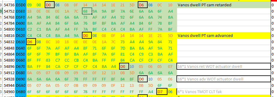

I noticed different rpm axes for vanos activation in 623 and 715. At high RPM in 715 vanos stays advanced a bit longer
