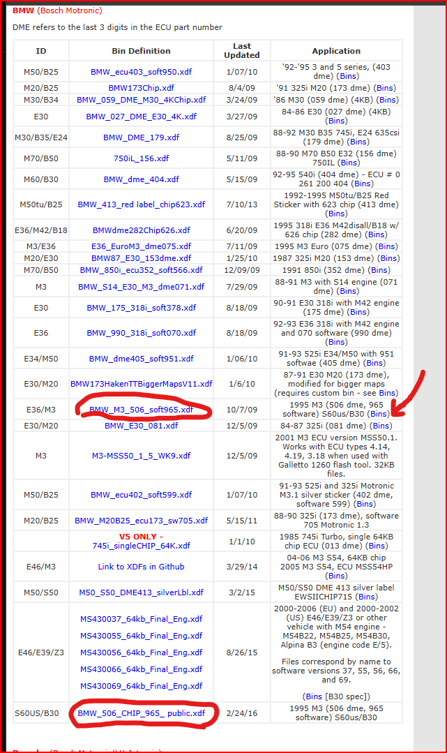

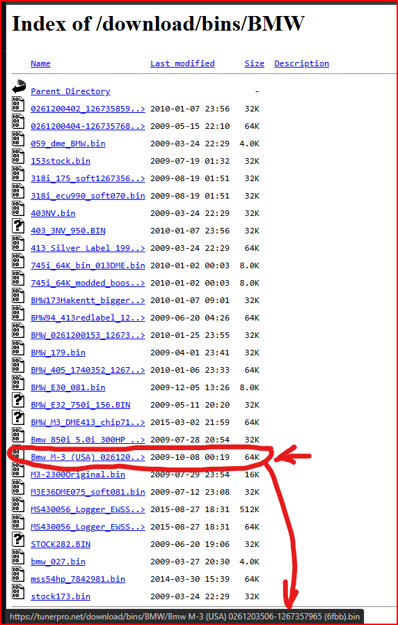

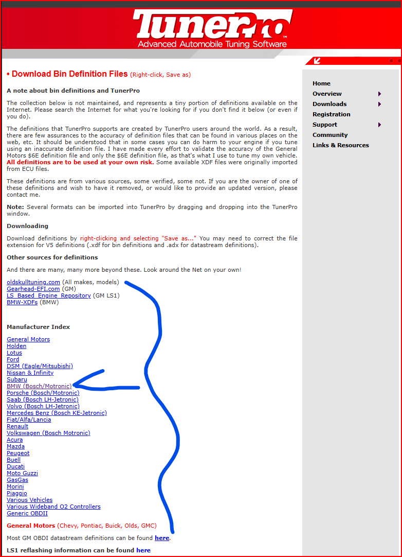

here is an example of getting matching files for a BMW E36 M3 with a ECU(DME) with part number ending in 506 and software version ending in 965.
Remember these are community files and can have errors in them.
