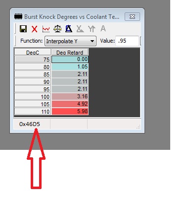

I often have a scalar/table open and want to know the item's hex address so I can have a quick look in the hac/code to confirm exactly what it does and when it does it. To obtain the address, I need to enter the xdf editor each time.
It would be good if the hex address was shown at the bottom of each open table, like this?

Thanks for the feedback. Ctrl + Shift + S should do it. You can reassign this in preferences.
The selected cell address is already shown in the toolbar. Seems like that could be used for lookup up the table/location in the hac/source.
