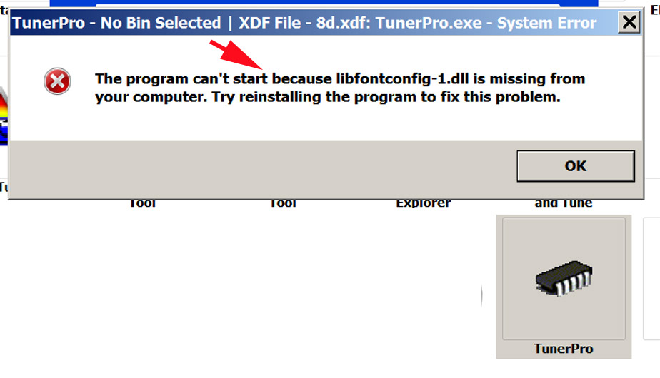

I just installed Tunerpro Version 5
to my desktop that has Mswindows 7 Pro
When clicking in the TunerPro software ICON to start the program, many different error popup screens show up such as below
What software is required to work with Tunerpro that the install process does not install
and if so where can I get software, .DLL, etc. to rid of these errors
Once clicking on each popup screen the TunerPro screen appears and seems to be functional
Thanks for any help on this

Acknowledging. We're working on this in email. Win7 should work, but it sounds like the VS2019 runtime isn't installing correctly on your Win7 instance.
