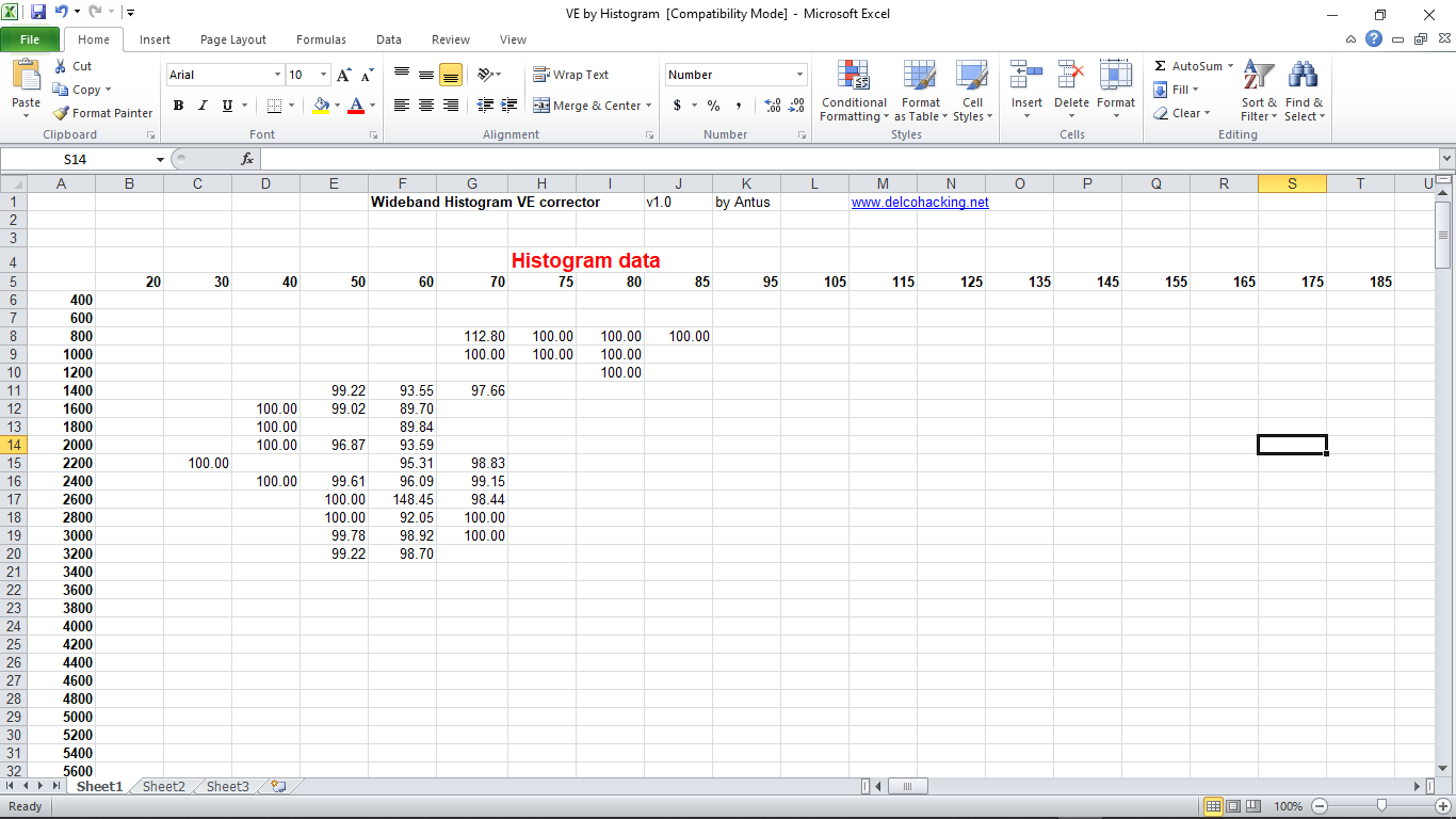

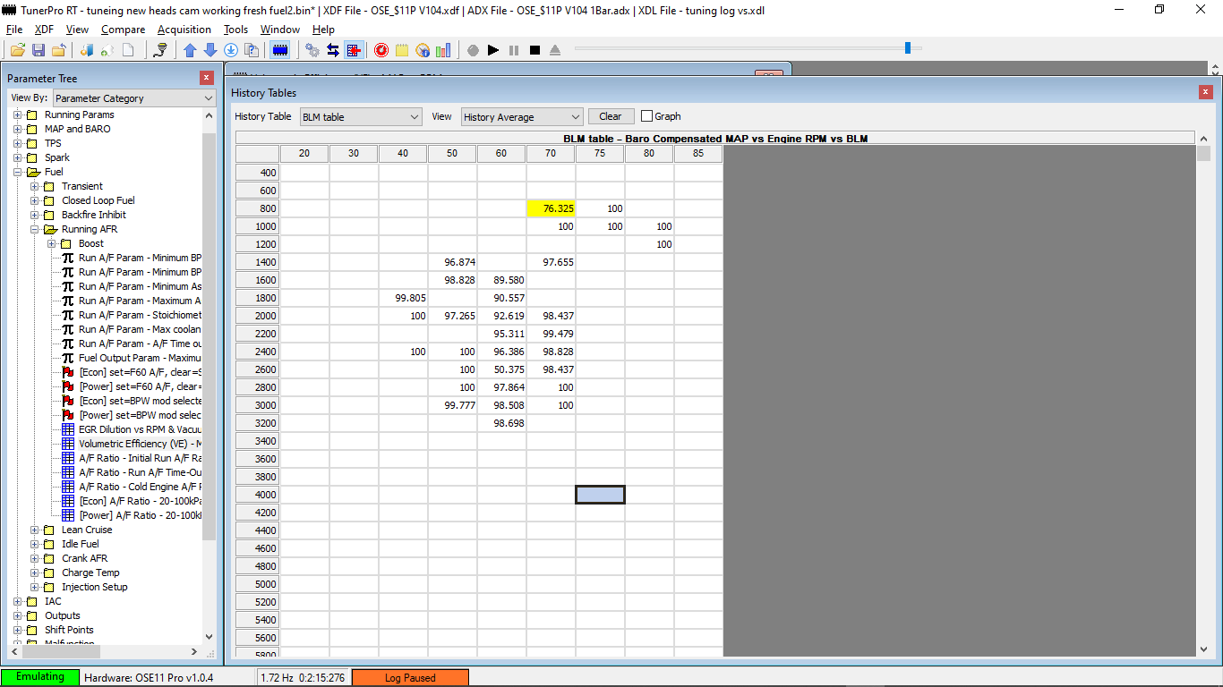

hey guys just having a bit of trouble tuning a holden commodore 1996 vs 5l auto 11p
im trying to tune part throttle/closed loop fuel tuning but having problems with the blm histogram at first i was getting weird numbers like -9.352 in the histogram then i edited the adx by copying a 12p adx setting into the 11p one and made it read correct numbers eg 100% 95.2% 98.7% but then pasting them into the ve by histogram on exel i end up with crazy results that dont look correct.
i will attach screenshots so you guys can see please any help much appriciated as i am lost and not sure if i am doing anything incorrect?
