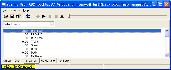

I guess it displays right in the Items List, but not on the dash.
Posts: 1967
moonwell wrote:I guess it displays right in the Items List, but not on the dash.
Ah, I missed where you specified that this was occuring in the dash. Correct. The dash only displays numbers.
