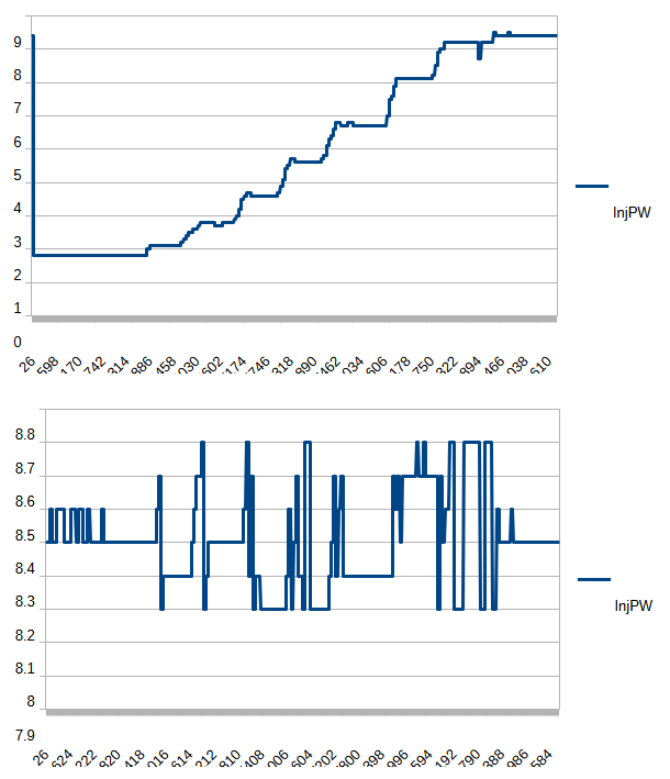

I've run into a problem where I can't trust the data from a selective export from a .xdl log file. If I export everything, the data seems OK in the .csv file. If I only export a few selected items, some of the data is bad in the .csv file. Attached are example files from a short benchtop test.
Here's what InjPW(ms) looks like when plotted from the full .csv file (top, good) and when plotted from the .csv file with only 4 exported items (bottom, corrupted):
Is this a known issue? Any way to get selective export to work more reliably?

I confirm that I see the broken behavior. Will investigate and fix. Thanks for the report and the repro files.

Are you sure, when doing a selective output, that you're selecting both the "Injector PW full (ms)" and its dependency, "Injector PW H"? If you don't and only select the former, you won't get valid data. When I first reproduced the issue, that was the mistake I made.
If you are still able to repro, so that it's easier for me to debug, could you narrow down your ADX to contain the minimum number of commands and values to repro the issue? I'm attaching a modified version of yours as an example. This still works with the log you sent.
