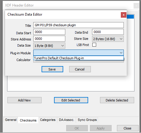

With the above XDF and DLL I'm able to get it to work, but when trying to create a new XDF the image below is what shows up.
Attached are pictures showing the error and when I verify the dll is selected it doesn't show up in the dropdown even though I have it in the folder "C:\Users\bubba2533\Documents\TunerPro Files\Plugins"
Even when I try to create a new XDF there is only the default plugin listed and the DLL doesn't show up.
No DLL Listed.png (14.77 KiB) Viewed 62549 times

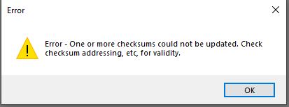

The same missing DLL happens with an XDF that I created, and I get an error when trying to save the bin.
Checksum Error.JPG (16.28 KiB) Viewed 62549 times

Re: Checksum Plugin Issue
I'm looking into this. Will fix what I find for the next build (to be released sooner rather than later, due to a couple of other issues).

Dear Mangus
build .9816 look like all plug-in.dll missing in drop down manu |Preferences|Data acq. I/O component Please check
Posts: 1964
See my previous post.
Also, the fix has been released.

Post by bubba2533 »
It's working for me, Thanks!
