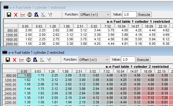

Hi,
on Build 5.00.9885.00 the table coloring is omitted after a compare switch.
See below: Transparent: compare switch once. Colored: As opened.
In the previous version that did not happen. Comparing is now a bit more tedious now.
( keep up the good work :-) )
Cheers
Harry

This is happening to me as well. just realized what was going on because right after a compare i couldnt manually highlight all cells in the tables to copy over.. wouldnt work at all. right click and selecting the option does. but as long as you dont compare all else works. if you close the table and reopen it you can continue editing..
im on version 5.00.9685.00

step 1 - open tuner pro
step 2 - open any table
step 3 - press the "show compare bin data" twice
step 4 - table data is now white and wont allow any highlight or selection
step 5 - close table and reopen and all is back to normal
opening any other bin or xdf has no effect on the issue.

I see why I couldn't reproduce this - it only affects tables that don't use internally defined axes. Of course I was trying to make it happen with tables that have internally defined axes.
Fixed for the next build. Thanks!
