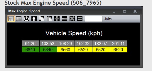

another think bro i wanna know , it about the rpm limiter
in the 413 506 M3 ecu ( i believe its m3 us which is basicaly m50 stroker ) have this rpm limiters depend on speed i wanna make the same think so i can do a " launch control" but this is very difficult for me , can we do it in the 402 ? a similar thing ?

Seems like that speed based rev limiter is only M3 (us and euro) thing.
In M3.3.1 this is very simple difference and i think it is very similar in M3.1.
3.3.1 ecu's -965.bin has this one table for rev limits. Program picks rev limiter value from table and stores it in to RAM. Rev limiter part of program is similar in fixed rev limiter versions and speed based versions, only difference is that address where the rev limiter reads rev limit value - Fixed versions reads it from ROM and speed based versions reads it from RAM.
