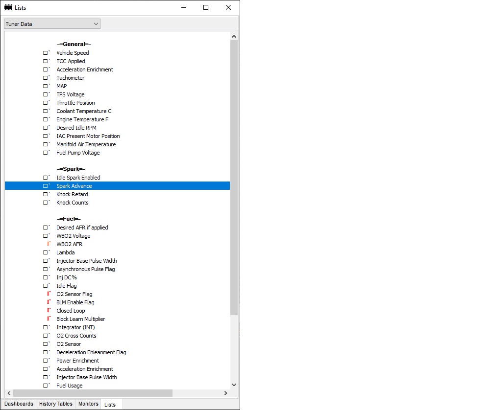

I'm seeing the same issue since I installed Windows 10 on my tuning laptop. I can recreate the same issue on my Windows 10 Workstation. I am using Windows 10 Pro 64 bit. My older laptop with Windows XP works fine. The datastream data is still there. Dash, history tables and monitors work fine. List view shows odd symbols instead of the flags and numerical data. Attached is a screenshot of what I am seeing. Maybe Mark will know what is going on if he sees this post. It appears to be a font issue but I may be wrong. No problem displaying 3d tables in wireframe. I have used Tunerpro for a few years and have registered. I am using the latest version.

I've finally been able to reproduce this and fix it. I'll be posting a new build that fixes this soon.
Posts: 1967
Re: Missing data in List view
New build is now available at www.tunerpro.net/downloadapp.htm
