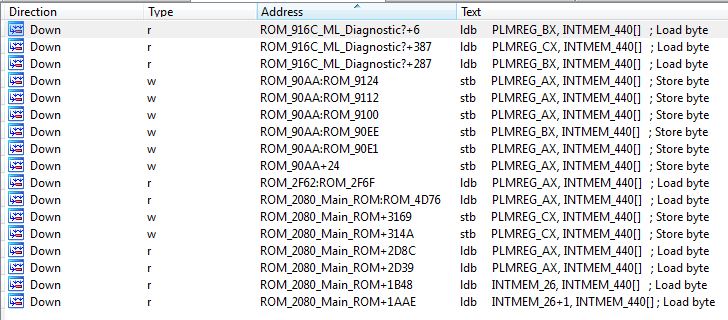

A little while ago I patched in Olafu's RAM dump and some data I managed to capture via INPA to fill out the missing regions of the code.
(I can't say the missing data is correct or perfect as they were snapshots taken from running engines, for all I know the data doesn't quite match as I could only snapshot 100 hex values at a time.) - but anyway...
The missing RAM areas were kind of interesting but only a small step forward, however combined with the info you just posted and some knowledge from the intel manual I get the following.
Now some immediately interesting things there, ROM:5358 is using the location of what I have flagged as the "diagnostic ID", seems it is used a few times following that long call to what you have indicated as the rom loading the tables
Secondly, ROM:33C2 instantly adds Register 1A to what I have showing as the ID location for the table of tables, i.e. the master table showing all the other tables in the ECU.
What are you using for disassembly?

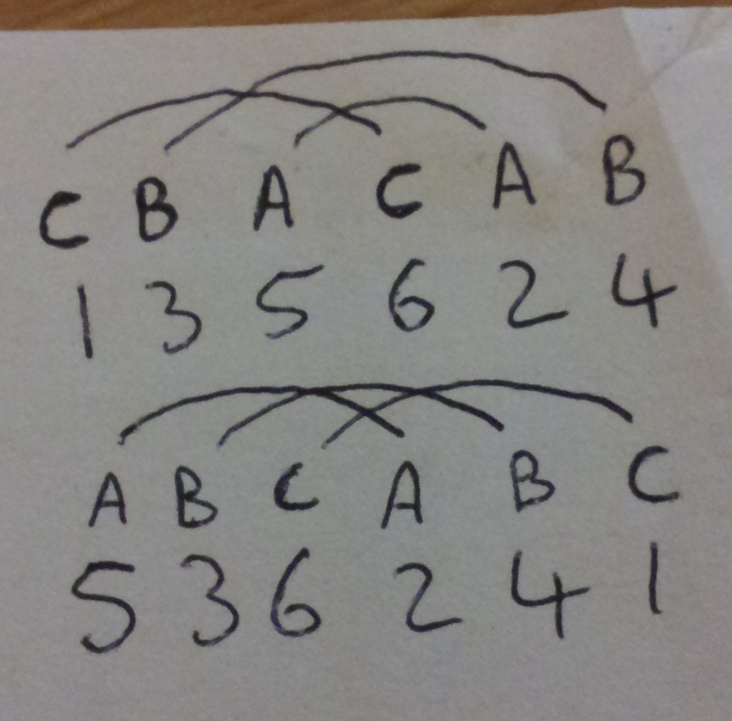

I agree about the 30131 chip being the coil interface on the M3.x ECU, this M3.3 uses one as well.
I wonder if the 30106 is only able to act as an interface for 1 coil as the M1.3 and M1.7x only dive 1 coil output? (M42 has a smart coil block that triggers the correct coil from 1 output)
I will upload some (probably a bit bad due to lighting) pictures of the board I have on my desk to the dropbox right now.
I have also been working out pins on the processor. I have put a bmp file in the dropbox photos folder listing everything I know about the CPU pinout already.
RE the 30106 - all of the 3 ecus I have here are 30106 (M1.7.3, M1.3, M3.3 and M3.3.1)
We can only assume they are interchangeable between the 30106 and 30318 as my rusEFI plug donor was a M1.7.3 with a 30106 in place of the 30318.
M42 coil pack is actually four "COP" coils in same package...
So, i think 30106 is used, because it has many other useful features, but, as example, only four transistor driver channels... So M50 and M60 needs separate driver ic.

Power on, no cranking:
0x4000 and 0x4001 are first readed bytes from external ROM, when power is switched on. Next comes 0x4120, 0x4121, 0x4122, 0x4123, 0x476B, 0x476C, 0x476D, 0x476E, 0x476F, 0x4770 and so on, sequentially up to 0x4816. Then comes 3.5ms perioid with no reading from external ROM. Reading starts again from 0x412C, 0x412D, 0x412E, 0x412F.
MAF table is in use. Reading interval ~1ms. Table reading happens in section 0xA4AA-0xA642...
https://www.dropbox.com/sh/xl0wftov6kgv ... uP9jAKxg9a?
0x2000-0x3FFF is internal ROM, and it can be different from external one's same memory area...
By the way, ecu works fine with blank EPROM from 0x2000 to 0x3FFF.

I am inclined to say everything in your post below is correct, which is good cause it means everything I can see on the disassembly so far is also correct...
I will send you a link to a live copy of the disassembly I have so far, that way you can keep up to date easily.
0x4000 is 5AA5h and is the first value read by ROM_2080 and put into register AX.
Intel sheets tell us the program starts at 0x2080 and that seems to be the main ROM which is what you can see running those first set of reads.
The MAF table being read from 0xA4AA makes senses with what I found yesterday.
From what I could see in the code ROM_418C was reading A/D channel 0 and was being called by a software timer interrupt, it was accessing the MAF table section at the right value for the airflow of the idling engine I took the RAM dump from.
Regarding 0x2000 to 0x3FFF - this is capable of being either in the MCU or on the external ROM, it is possible to decide where it is called from by setting pin 2 (EA) on the MCU to high or low.
The default is set high, connected to Vcc, and that forces it to read from the MCU, earthing out that pin and cutting the 5v+ will force it to read from the ROM chip.
We are just lucky that the whole of the ROM code is on the EPROM.
I suspect that there may be some ECU modding coming in the near future.
Link to the disassembly in your inbox now. If you have questions (and I'm sure there will be) then let me know and I could set up a quick slack channel or something to get us up to speed with any open results or questions posted back to here.

Regarding the 0x0440 address, the cross references in the disassembly show the following, I don't know how helpful this is?
- 0x0440 cross references.JPG (87.04 KiB) Viewed 362427 times

Yes, with M60 bin, ignition firing sequence is going to 2-9 also with 413 board. And those pin 8 and 9 (T507 and T508) transistors are missing. But 7 and 8 cylinder's injection pulses are not seem to come out from anywhere. https://www.dropbox.com/s/e0o8zid3mf7se ... 4_bin_.BMP
In 413 ecu, firing order is everywhere 536241. -> =153624 with 1 cylinder flipped from first to last. I can't say why.

Your right that is odd, the firing order is 135624 so that sequence is correct for 624 but 3 and 5 are reversed.
I think this is due to the ECU running in wasted spark mode when there is no Cam signal for sync.
If they are laid out in firing order then it means the channels are triggered in an uneven pattern.
I have named the pairings A B and C in the image below, you can see how the pattern would not work if the channels were laid out in the normal firing order.
I think with the V8 order it is not a problem as each bank would pair up in order, I need to double check the pairings for wasted spark but I think it holds up.

No, it is synced now with faked cam signal.
153624 -> 536241 it's same firing order, but it only starts from 5. I think this is something to do with 120 degrees different trigger wheel position. Maybe only BMW engeneers can say why this is changed.
