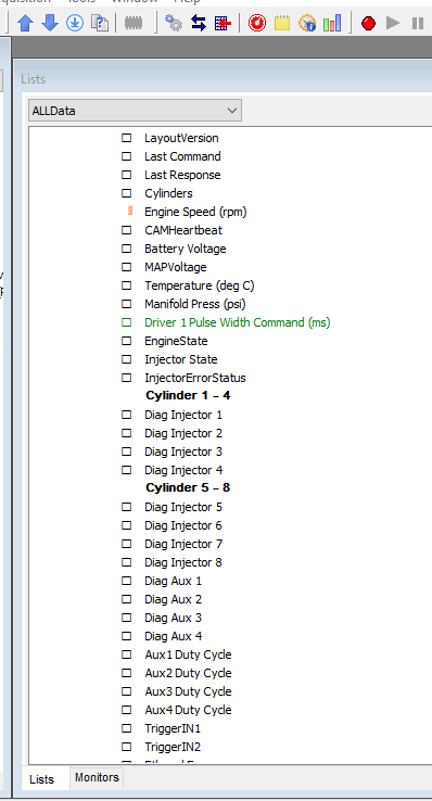

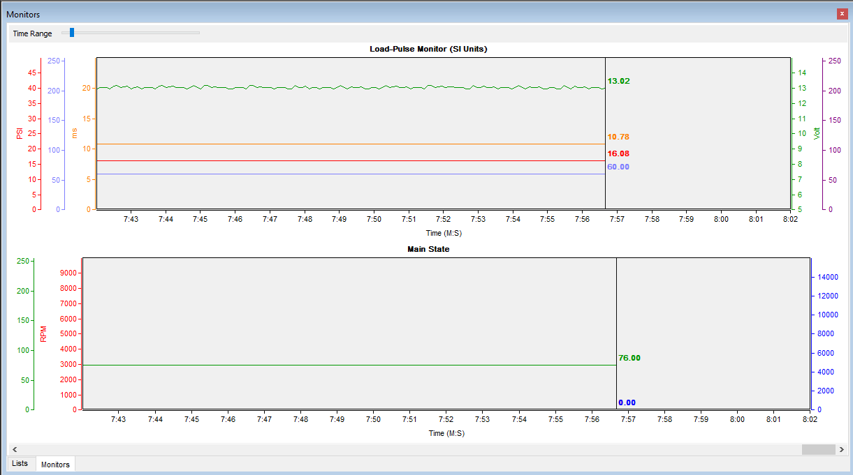

I am getting a weird error on my TunerPro RT list view. It shows squares instead of the actual data, but the Monitors view shows the data just fine. I have tried resetting font settings on PC, different .adx files, downloading old versions of TunerPro RT, deleting TunerPro RT settings files, reinstalling TunerPro RT, and numerous other combinations of things which all do not fix the issue. This was a known issue in the past and v5.00.9209 "fixed" this issue. The issue I am having happened randomly with no explanation really to why or what caused this.
Please let me know your thoughts and advice, any help is welcome. I have attached pictures to show more details.

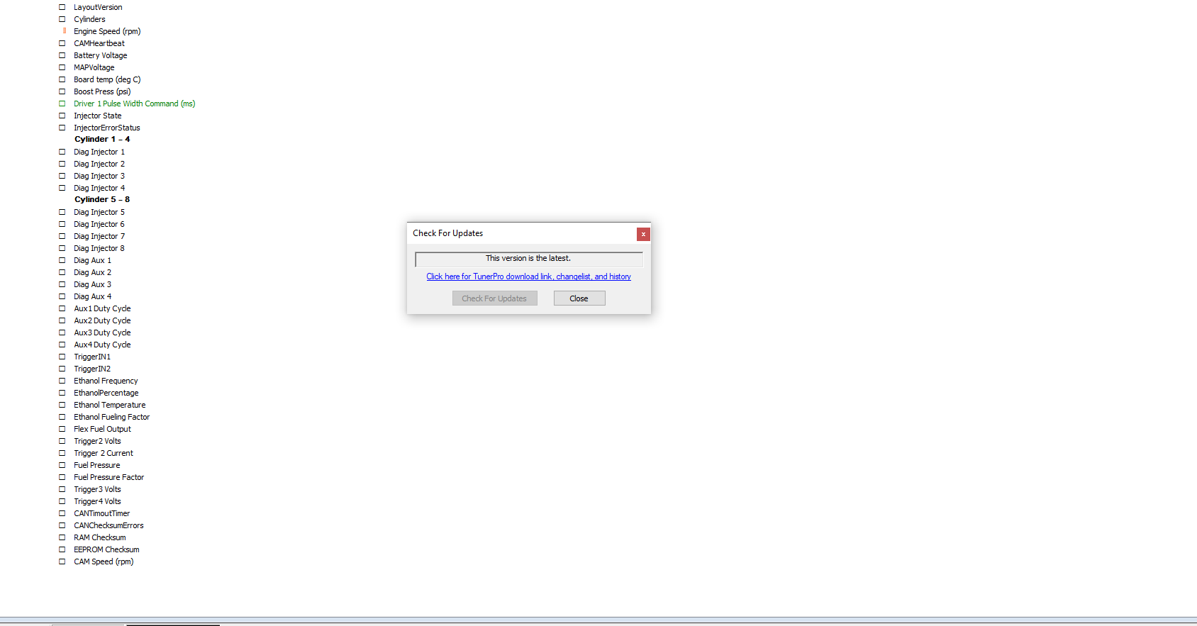

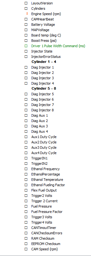

Issue seems to be in the tunerpro rt software. tunerpro rt version 500_9209 I found works for a fix for data list (Tested on PC and my laptop)
Updating back to 500_9995 reintroduced the issue on both devices

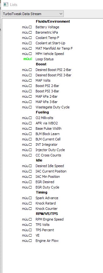

I've been having the same issue. However, when I updated to the latest Windows 10 software today, the result in the Data List view changed a bit. Maybe this is a clue?

I'm not entirely surprised that this would be tied to OS or the runtime, which explains why not everyone is seeing it. I'm still unable to repro on every one of the 8+ machines I've tried it on.

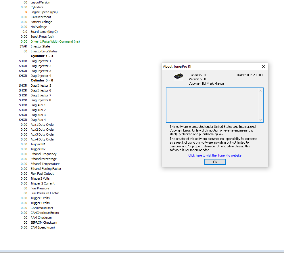

I just went back to 9209, and I'm getting nothing in the Data List view now... no square boxes, not what I posted earlier.
I'm on a Dell laptop.
