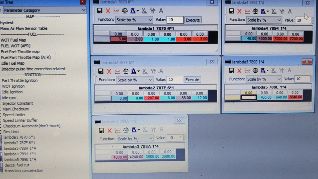

Hi found those lambda Maps for 402
7870 6*1
787e 6*1
788a 4*1
7894 4*1
789e 4*1
But lambda off isn't working.
Any suggestions ?

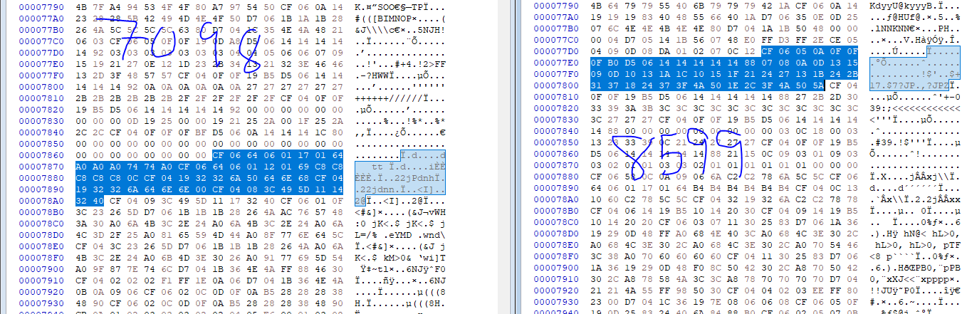

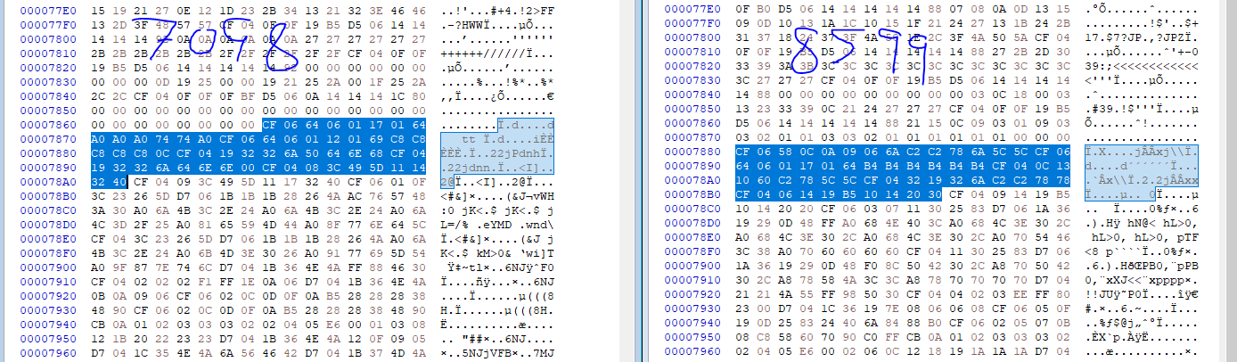

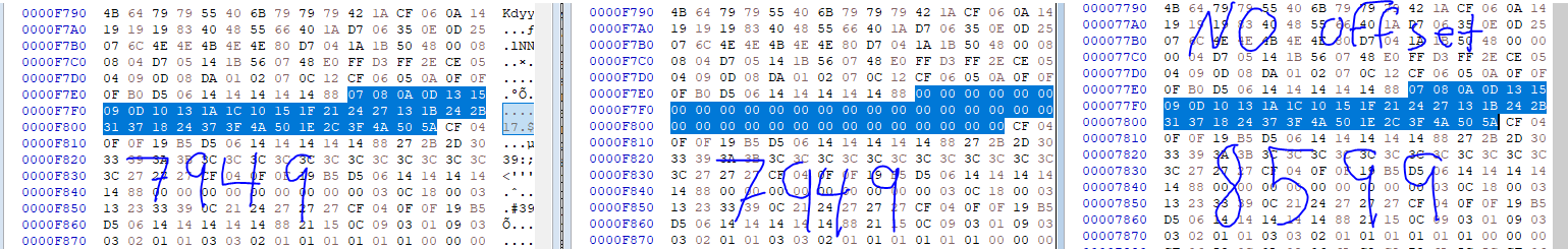

see That Hurxkens and adhamkhe have the same map locations and the data is completely different I think there is a version of BIN and version of XDF mismatch somewhere. Internal location markers in the ROM indicate the ROMs should start offset to x8000. I do not think any of the public 402 bins/xdfs are setup this way making it cumbersome to hunt around in the files.
In the 413/506/M3.3.1 cars the fastest way to turn lambda off is to unplug the lambda sensor. Same for the MAF, unplug it and the DME uses the fault map to run the car. I do not know if the 402/3.1 cars have the same fault map
To the lambda. The lambda maps where defined at 0x7870(no x8000 offset...but it should be) in the 7098 software version from some public sources. The 8599 software has different data there.
Turning off lambda in software usually means setting the data of the tables to either 00 or FF for all the lambda tables. For the 7098 software these x7870 tables would all be set to 00/FF.
In 7949 and 8599 software I believe the structure has changed and my guess is this CF(6)RPM x D5(6)Load table Data at x77EA(or xF7EA with proper offset) This table is marked in the index of tables in the ROM. All those offsets only line up if the files are properly setup. Middle image 7949 soft is set to all 00 and is supposed to be a lambda off ROM. YMMV. This may be a RPMvLoad disable map. In 8599 there are the 2x 6x1 and 3x 4x1 maps at x7880(first data at x7886) These look like the same maps that got defined in the 7098 software but cannot be sure without testing.

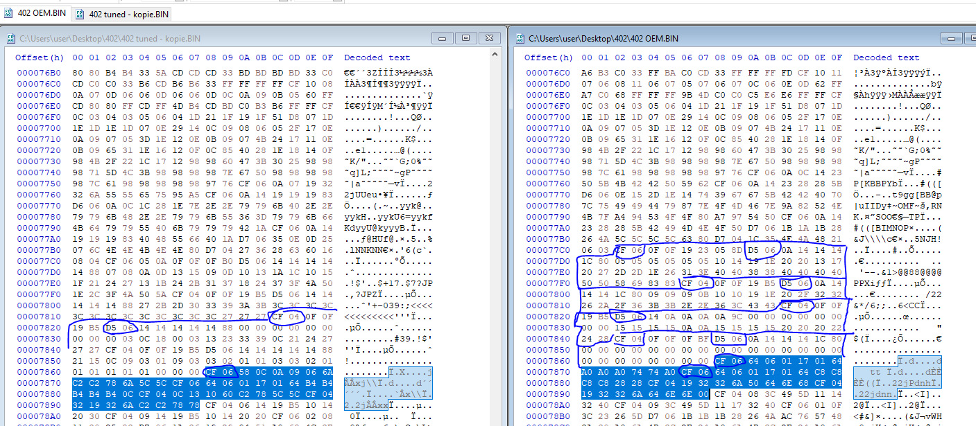

h 402 oem.PNG (31.38 KiB) Viewed 25130 times
h 402 tune.PNG (19.57 KiB) Viewed 25130 times
This is the data in your files. CF and D5 are axis label/descriptors.

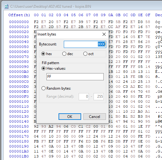

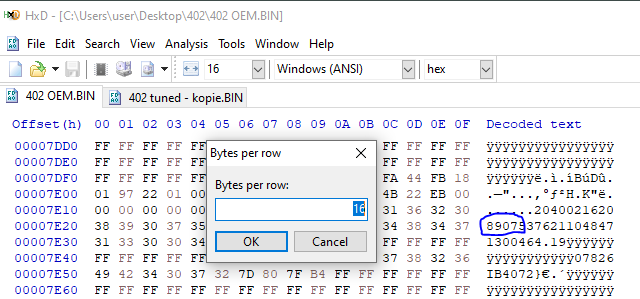

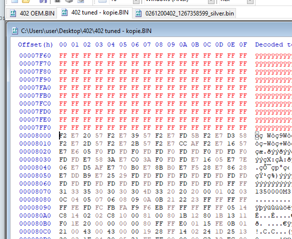

Step 1:
Insert filler
h insert filler.PNG (43.83 KiB) Viewed 25128 times
What the new offset looks like
h new offset.PNG (34.87 KiB) Viewed 25128 times

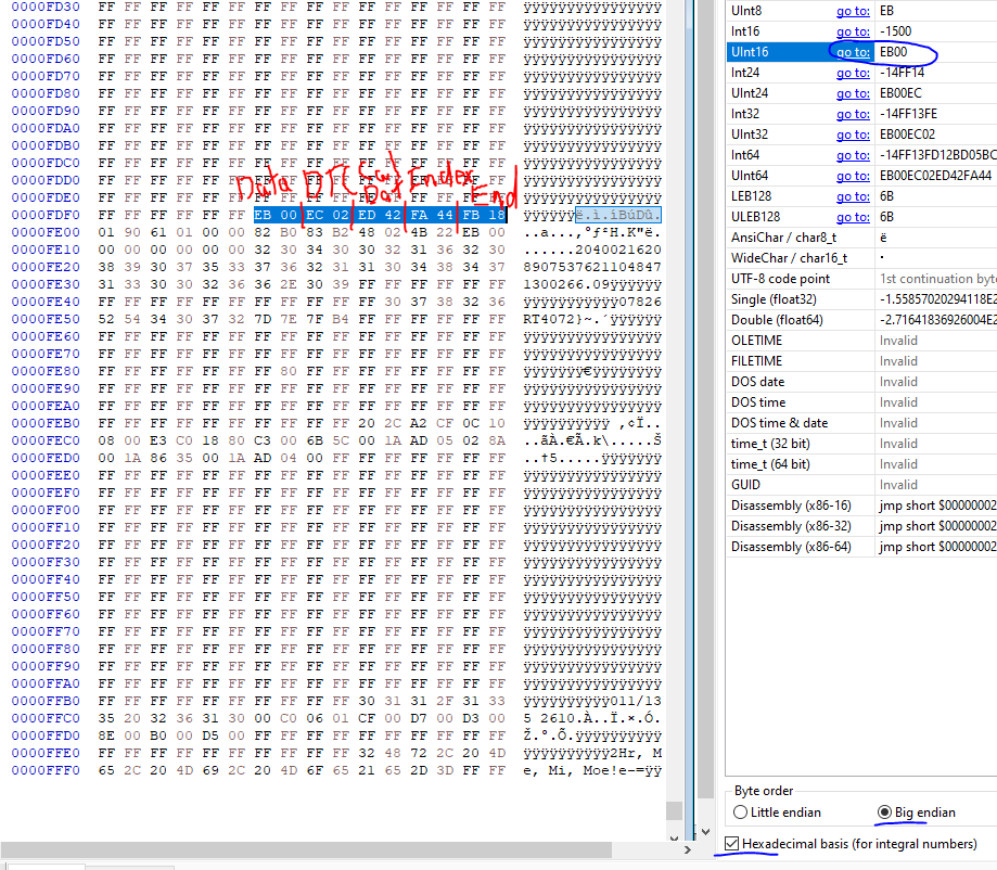

Now in app HxD you can highlight hex and jump to location of address. note some location are in big endian and some are in little endian. (forward and reverse reading of the bytes)

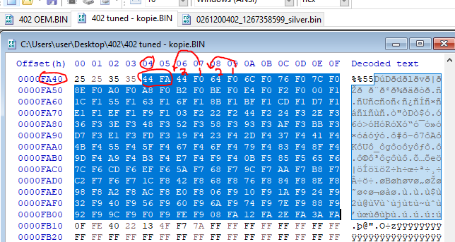

Step 2:
Image show some special bits that give you the locations of the start od the DATA calibration section. Here you will single values stored, next is the start of the DTC code settings area, next is the location of the DATA in table forms, Next is a index of the location of all the tables that have axis info included, then the end of the calibration data is marked
index of loc.PNG (80.66 KiB) Viewed 25128 times
Re: M50 402 disable lambda
Posted: Tue May 06, 2025 10:02 am
by nomecone
Step 2 continued
Here at FA44 this first a self address so you know you are in the right place. 44 FA -> FA 44 . Next is the location of each table written in little endian, last byte first.
So 44 F0 -> offset F044 - this is the location of the first table
IOT 402.PNG (40.74 KiB) Viewed 25128 times

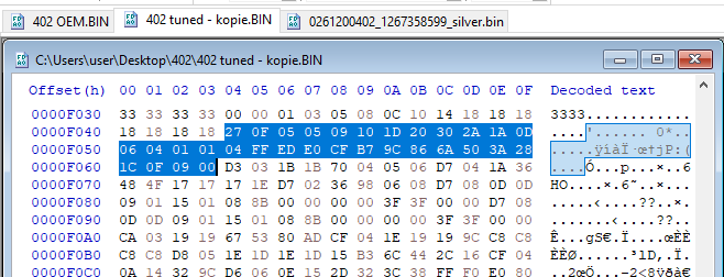

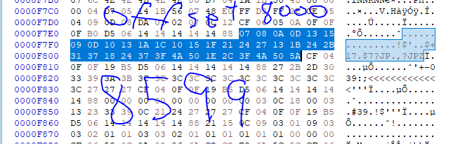

Step 3 begin...
Going to F044 you are at the first table
27 is the axis label/descriptor
0F is the number of axis points
followed by 15(0F) axis point numbers
followed by 15 data points
Then D3 at location F064 (which is in the index of tables) is the start of a new table. D3 is a descriptor.
h 1st table.PNG (27.87 KiB) Viewed 25128 times
Hope this helps you get started.
