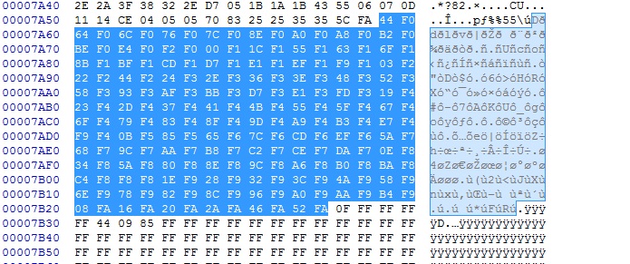

Someone familiar with m50 402 motronic 3.1 ecu, can please help me to find the table who have the adresses for all the other tables i mean something like "the table of tables"
the ecu use this table to "know" the adresses of the other tables
thank you very much

-599.bin: First table address founds from 0x7A5E "44F0" -> 0xF044 -> it has 8000h offset: First table founds from 0x7044.

you mean the table who have the adresses for other table start from 7A5E ? and finnish in 7B33 ???

Yes, but last table address is in 0x7B2A. (so last table starts from 0x7A52, it's just before this map lookup table)

if i undertand you well this should be "the table of tables" ???

Yes, it is "the table of tables". F044, F064, F06C and so on are map addresses, but you must subtract them by 8000h, so you will find the maps from 7044, 7064, 706C and so on.

i'm searching for it so i can use it after i extened some table
for exemple i wanna extend the WOT fueling table to 7000rpm and make new adress for it , and i MUST change the adress also in the " table of tables" so it can work , if you understand what i wanna do

I think you can also move this map lookup table to make more space to increase size of existing tables.. 0x7DFC-7DFFF (FA 5C FB 34). FA5C tells to ecu where is start of the table (there is two bytes "self reference" at start of this table) and FB34 is first "blank" byte after checksum. Also you have to correct the checksum calculation "Data End" address and particularly "Store Address" from your XDF. Otherwise tunerpro will overwrite something if checksum correction is on. Propably some part of map lookup table, depending how much space you did by moving things...
You can make a "New table" in your XDF from this map lookup table, and change several addresses at one time. With conversion x-32768 you get corrected values. The original maps are in rising order (so table editing is pretty easy), but in some other motronics (e.g. Opel 20XE) there have also been lookup tables, which uses the same map in several places.
If you want to increase size of several maps and you don't move whole map system, the space runs out from chip, because you always have to recreate the whole map. Free space is enough for approximately two bigger 3d maps or several 2d maps. Unused space of old maps can be more difficult to reuse than moving whole system.
