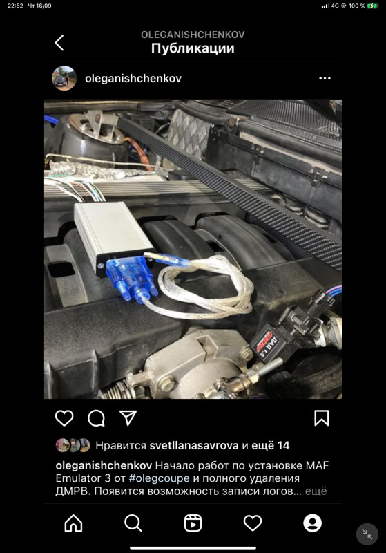

Guys, not many succeeded with MAF to MAP hand conversions.
There is a ready and reliable MAF emulator 3 in one Ukrainian shop for 350 USD which has a huge amount of functions and can replace ANY 5Volts MAFs. It works with original or aftermarket MAP.
MAF can be completely deleted and you have limitless airflow.
I am using it for a year now and happy as f.ck because it can also make logs

Lies!!!
This freak on an 8-bit ADC / DAC cannot completely replace the air flow meter !!!
It is IMPOSSIBLE to fully tune the engine due to calibrations and limitations at the input of the standard ADC of the computer.
An attempt to recalculate the pressure in the manifold and translate it into a maf signal is a pain in the ass.
All turbo projects based on the maf emulator end up in a dump of burnt motors!
Why deceive readers?
"Oleg coupe" will find a market for his homemade products, and there is no need to try to promote them!
