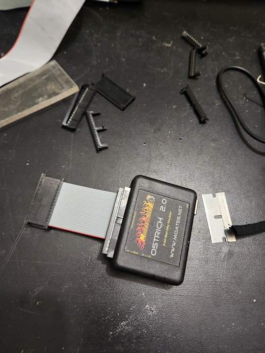

Supplies came in to make a new cable! Glad I ordered enough pieces to do several because I F-ed up a couple connectors before I got it right. The real pisser is that I had to order 25ft of cable to make one 4 inches long. If someone needs a cable, hit me up. I should be able to try it out tomorrow evening. I did verify the file with my eprom reader so I'm confident I got the cable assembled right. Fingers crossed this fixes the problem.
ostrich short cable.jpg (160.47 KiB) Viewed 37827 times

Plugged in my testing ECU with the ostrich connected using my new short cable. Engine fired right up. After a round of self high fives, I grabbed a usb cable and connected it to the laptop. Opened the XDF and relevant bin to find that data tracing is working too!!!
This is a huge win and is going to allow me to develop a tune for this ECU! Thanks to all who replied!
