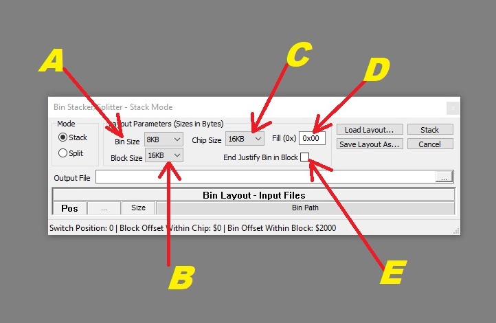

BTW: The "bin stacker" demo screenshot in the instructions doesn't match the 5.0 release screenshot. Couple extra boxes....think I figured it out.

Are there instructions for using the Block E option? When do you check this block?
