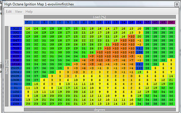

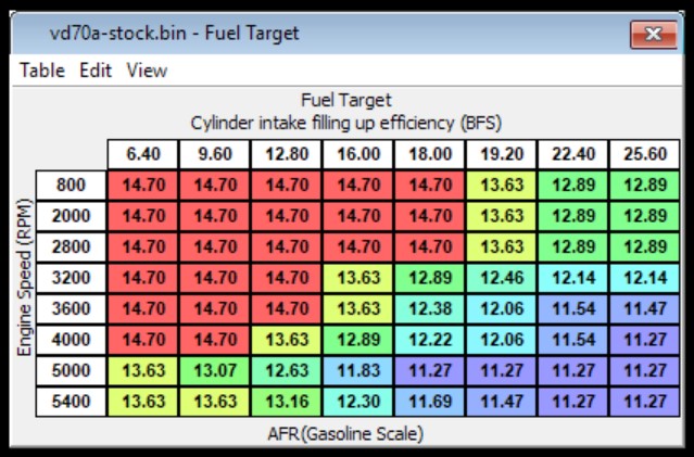

I'm struggling with the lack of axis labels on 3D maps. I work with multiple unit types that both scale from 0 to 100. I'm attempting to sell some XDFs but it's hard to explain to tuners that the 0-100 load scale on one map (QH0 unit) is not the same units as a 0-100 load scale on another map (ITAC unit).
A label at the bottom for cell (Z) units would be handy too.
I have attached some examples of what I mean from RomRaider and ECUFlash. TunerPro is still my preference for other reasons but not having axis labels is really hard.
